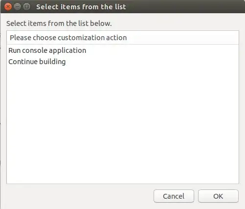

I have Ubuntu 14.04 and I want to create my own customized Live CD. I chose to use the Ubuntu Customization Kit, which I added as a package to my Ubuntu install on my Hard Disk. Now I would like to add some packages to the LiveCD. When attempting to use the Customization Kit, I get the question:
Would you like to continue building, or use the console?
If I choose "Continue building" the iso file gets created and I have no option to include the extra packages I want. If I choose to use the console, no package manager starts.
There is no "Run package manager" option available.

Select console application from your prompt and then when it appears run
echo -e "\ndeb http://archive.ubuntu.com/ubuntu/ trusty universe\ndeb http://archive.ubuntu.com/ubuntu/ trusty multiverse\n" >> /etc/apt/sources.list
to set apt-get sources and then
apt-get update
apt-get install vlc
