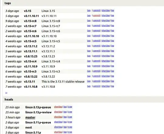

with the exact kernel source, which I suppose should be stored in http://kernel.ubuntu.com/git?p=ubuntu/linux.git;a=summary?
In that page there are quite a lot of tags, for example:
But none of them correspond to 3.13.0-29 which is my running kernel right now.
The mapping should be in https://wiki.ubuntu.com/Kernel/Dev/ExtendedStable, where it is said that the 3.13 Ubuntu kernel is based on 3.13.11 --- I think. But from there to finding the tree I have installed is not straightforward.
The best options seems to go to linux3.13-y.review or linux3.13-y.queue, but I am unable to find where this tree are marked for the release - if I understand well the policy, in -review the patches are accumulated for testing, and in -queue accumulated for the next minor release/update --- but I am unable to find the exact release tree. I mean, a tag equivalent to 3.13.0-29 was cut here.
Is that the tip of linux3.13-y? In this moment it is claiming it is 3.13.11.2: where can I find a reference that links that number to the result of my uname -a (which is 3.13.0-29)?
