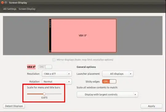

Unity, the default desktop for Ubuntu, does not have much option for scaling displays. Since 14.04 however, you should be able to adjust the scaling of the launcher and panel in Settings: Look in the Display settings for 'Scale for menu and title bars'
In the 'Apperance' settings as well, you can change the icon size in the launcher.
