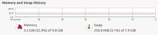

This is my memory and swap history, which doesn't seem to include any information about "cache". I realize at this point I'm not totally clear on the difference between "cache" and "swap":
memory and swap

And my "cache" still slowly maxes out and my computer slows as a result.
You'll need to look elsewhere for the cause of your slowdown; the memory described as “cache” is the memory that the kernel can freely throw away if anything else needs RAM. It's things like data recently read from the disc.
This, while quite old, is still a reasonable description of some of the moving parts in the memory subsystem. As it says,
Linux has this basic rule: a page of free RAM is wasted RAM.
No matter how much RAM you have, your cache will grow to fill it. This is not a cause for concern. Far from it, it's a very significant performance optimisation - RAM is about 100 times faster than a fast SSD, so any time you don't have to read from disc is a huge win.

250MB isn't a lot, so I wouldn't be terribly worried, but for a high-RAM desktop system for interactive (rather than server) use, I might experiment with reducing swappiness, to change the balancing act here. This answer is very good on why it probably won't make much difference, but it's a reasonable thing to experiment with to see if it goes.
You've a much bigger problem to deal with first, which is that someone is running sudo sh -c "sync; echo 3 > /proc/sys/vm/drop_caches" on your machine every now and then, which clears out quick-to-access data from otherwise unused RAM and forces the system to recalculate or re-retrieve what it should be able to just grab from memory. That's going to make the system slower, and the RAM a waste of money.
