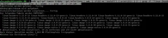

Remove old kernels
Run this command in a Terminal:
sudo apt-get remove $(dpkg --get-selections | awk '{ if($2 == "install") { print($1); } }' | grep -P '^linux-(headers|image)-(?!generic)' | grep -v "`uname -r | grep -oP '[^-]+-\d+'`")
Example output
This will attempt to remove all kernels from your system except the one you are using right now.
After reviewing the list confirm by pressing enter.
DO NOT CONTINUE IF IT SAYS SOMETHING ABOUT UNSATISFIED DEPENDENCIES!
As you can see in the screenshot this would free up about 1GB of space... all of which resides in the /boot partition!

I finally got it to work following Alexander255 's code but sudo apt-get remove was duplicated so i removed one of them and use the code as stated below:
sudo apt-get remove $(dpkg --get-selections | awk '{ if($2 == "install") { print($1); } }' | grep -P '^linux-(headers|image)-(?!generic)' | grep -v "uname -r | grep -oP '[^-]+-\d+'")
and it worked perfectly. Thanks so much.
