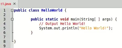

Am using Geany editor in ubuntu 13.10, Is there any shortcut key to align code (auto-alignment) in Geany editor?
For example : in Eclipse - Ctrl+Shift+F to invoke the Auto Formatter

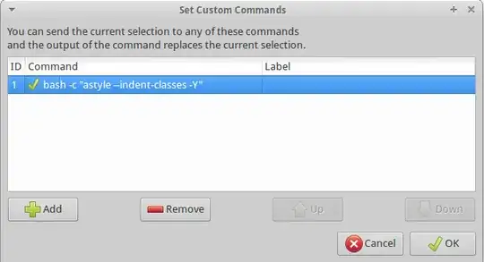

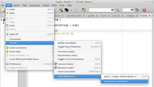

  3. Add a custom command to Geany:
    bash -c "astyle --indent-classes -Y"
    To customize this look at the Artistic Style documentation
  4. Select an text area and press Ctrl+1 to run the first Geany custom command
