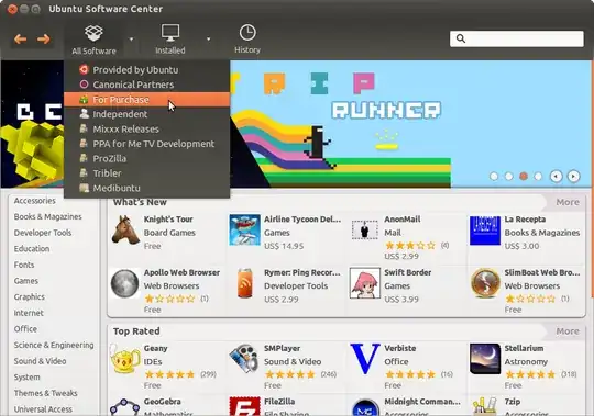

The Software Center has a section of For Purchase programs —see screenshot below—,
which is annonying me every time I want to install something.
Is there any way to remove or hide these programs from the Software Center?

The 'For purchase' section of the Ubuntu Software Center.
