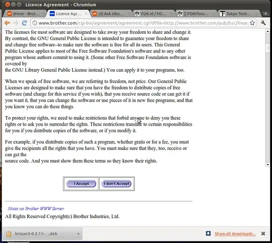

Ok I have downloaded your file and will show you how I do it:
After accepting this page:
The download starts and when it finishes at the bottom I click the little arrow next to the file and choose 'open'. Since it is a DEB my system takes over by issuing Ubuntu software Center to install it:
Hit install and it should work on your system.
No need to mess around with command line (that's oldskool ;) ).
