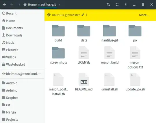

Here you go: https://github.com/bil-elmoussaoui/nautilus-git/ Works with both Nautilus & Nemo on Gtk3.14+ enter image description here
Not perfect, does not implement a lot of things but help/ideas are welcome!
