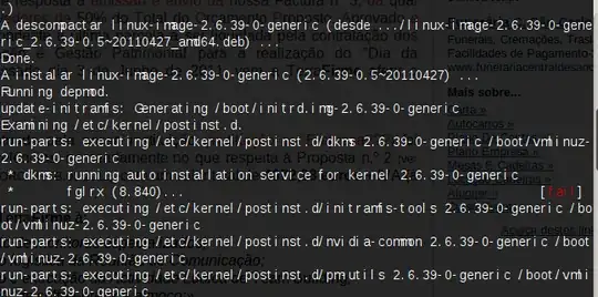

I've installed this new Kernel version (2.6.39.1) and it seems to me that isn't stable. When i boot my laptop it blocks.... and it shows a Fail on Graphics... What is the problem?

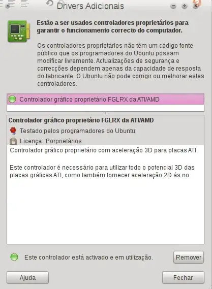

I've installed proprietary drivers FGLRX.
My Laptop is a Acer Aspire 5542G AMD64 bits ATI Radeon HD4570 4gb Memory
I'll wait for an answer, please...
Here it is my proprietary graphics:
This installation problem shows me this:

A very similar Question was recently raised here.
The resolve the black screens for the proprietary FGLRX catalyst driver, you will need to patch the kernel.
Therefore, boot with your natty kernel and remove the FGLRX catalyst driver. You should be able to boot with the open-source driver. Reboot into the new kernel.
In the linked question try either of the two solutions depending upon whether you are using Catalyst v11.5 or Catalyst v11.6.
