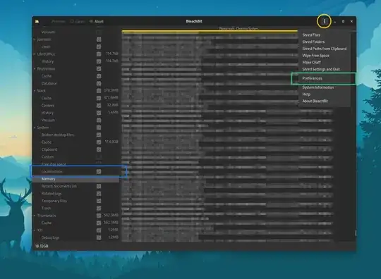

This is my first answer on this site. BleachBit is able to remove files for unwanted languages in your system and applications.
Install BleachBit from your Ubuntu Software or terminal (sudo apt install bleachbit) and open it as root (sudo bleachbit). Go to Preferences and under Languages check all the languages you want to keep. Now on the left panel, under System, check Localizations. If you want to know how much space these localization files are taking up in your system, click the Preview button. Use the Clean button to actually free up the space. Hope this helps.
BleachBit screenshot
In the screenshot, you can see BleachBit deleting localization files from gedit text editor.
