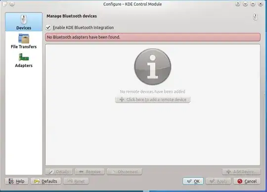

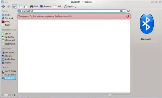

Now I want do the same in KDE (at Dell E6410 Kubuntu 14.04). However, if I patch the file as above I am not able to turn Bluetooth On any more during the working session, the icon disappears and even error message is hanging in a proper window until cold power cycle. enter image description here and enter image description here

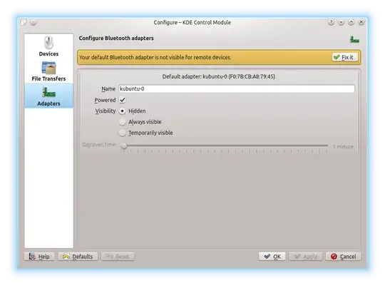

Nevertheless there is place to (un)tick 'Powered' in tool Configuring Bluetooth -> Configuring Bluetooth Adpaters , please see this screenshot below. enter image description here I would like not to have this ticked at the startup. How to do that? I have not found setting which specifies this in any KDE tool, that's why my question is: how to the same what untick 'powered' does but from the command line? Then I could add such a string to, say, /etc/rc.local. The direct answer I did not get yet.
