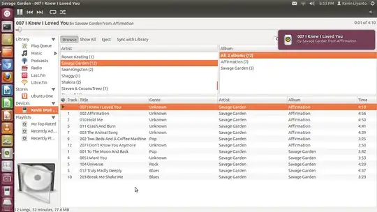

Use Rhythmbox
Ubuntu's default music player Rhythmbox can Sync music with iPhone and other iDevices:

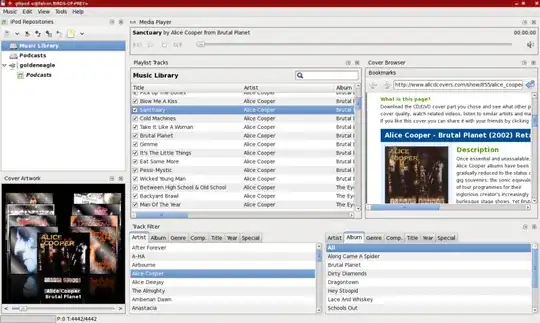

or there is another program:
gtkPod
This can be installed from Ubuntu Software Center.
