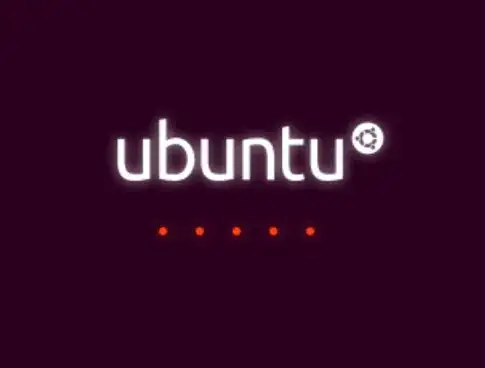

Then I do the checkout and build and everything works perfectly as long as I don't shut down. Once I do a shutdown, this thing will not boot. It gets stuck at this screen:
Ubuntu boot splashscreen
And it will sit here forever. It doesn't seem to take any input at all (Esc, Alt-F1, Ctrl-Alt-F1, etc...) and the progress indicator has stopped.
Has anyone seen this or know what's causing it to hang here? I can boot to a live CD and access my filesystem, make a backup of my files, and reinstall. But as soon as I shut down, this happens again.

first you should check if you can change to the console output by pressing F2 or ALT-F2 (never remember which one )
If that does not work or do not show you some error you should reboot and enter the grub boot menu with pressing "Shift" while booting.
When you are in the menu you should remove the "splash" and the "quiet" entries from the kernel commandline.
This way you will get the "normal" output Ubuntu (and a lot of other distributions these days) usually hides from you.
With the error(s) you might see there you can debug your issue and fix it.
Thanks a lot, It worked for me, but I had other problems. so I will give you some tips:
when I waited to the Splash Screen to press Ctrl-Alt-F1, it did not work
- try pressing that all the time before Splash Screen appears
To edit grup
$ sudo nano /etc/default/grub
-delete quiet splash in GRUB_CMDLINE_LINUX_DEFAULT="quiet splash"
 so, it will be GRUB_CMDLINE_LINUX_DEFAULT=""
When I tried to sudo apt-get install --reinstall ubuntu-desktop, I got unmet dependencies,
 -I also did $ sudo apt-get install unity
  but I do not know, if it was part of the solution
 - upgrade and update
 $ sudo apt-get upgrade
 $ sudo apt-get update
then it reinstalls without problems, then reboot
$ sudo reboot
Now, get back to work
