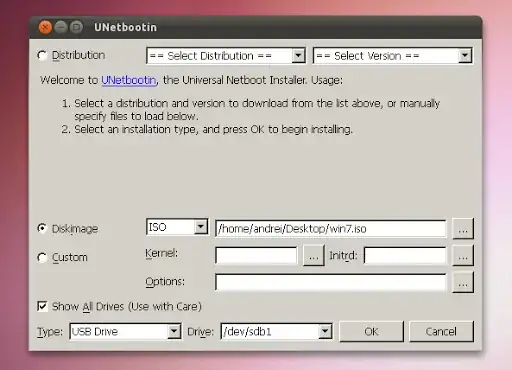

To create Bootable for windows 7 install unetbootin:-
click here to download unetbootin: http://unetbootin.sourceforge.net/
You can even download from Ubuntu Software Center. Just search 'unetbootin'. enter image description here
Visit here for detailed information:- http://www.webupd8.org/2010/10/create-bootable-windows-7-usb-drive.html
