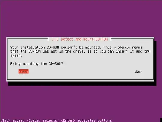

  • Ubuntu Server seems to successfully load vmlinuz and initrd.gz, asks for the language, then the location, then the keyboard layout, and finally complains that it can't mount the CD-ROM:
Your installation CD-ROM couldn't be mounted. This probably means that the CD-ROM was not in the drive. If so you can insert it and try again. Retry mounting the CD-ROM? (Yes) (No)

What explains the fact that it requests the CD-ROM and how to avoid it?
I had the same problem trying to PXE boot the 14.04 server-amd64 disc. I finally noticed I had used the wrong initrd.gz. Make sure you are using the one from /install/netboot/ubuntu-installer/amd64 on the disc. The filesize for mine (14.04, not 14.04.1) is: 21256771.

The server version needs a different append
i.e.
append   = initrd=NWA_PXE/$HEAD_DIR$/install/netboot/ubuntu-installer/amd64/initrd.gz vga=788 mirror/country=manual mirror/http/hostname=$IP_BSRV$ mirror/http/directory=/$HEAD_DIR$ mirror/http/proxy=""
Note: this append is taken from Serva, you should customize it to your particular directory structure, also consider it uses HTTP instead of NFS.
