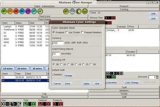

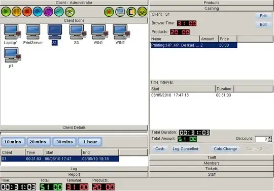

After a miracle (Because I never found something to control a Cyber Cafe, I was provided with this: http://mkahawa.sourceforge.net/
Which is exactly what I was looking for:
It even has packages for Ubuntu: http://mkahawa.sourceforge.net/downloads.php

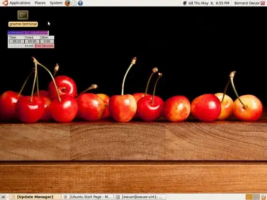

I have also found mkahawa is the only one as Free software out there which is not too old, and provides many features. I don't know yet if all needed features are fulfilled, or even if the features it has all work well. I don't have yet experience with it.
However, as it has been advised to me to use the SVN sources to make it work well in Ubuntu LTS: for now 12.04 Precise, I have also put up a light version of Ubuntu with Openbox (which has been worked on prior, during several months as a contribution). Those who would be eventually interested can read about it starting from here: Ubuntu with Openbox, easy features and Mkahawa in it
