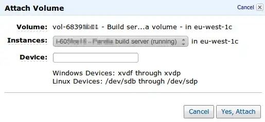

So, I opened AWS management console, created a volume, and attached it to the instance:
I chose /dev/sdb as suggested by the dialog. AWS console shows the volume as correctly attached to the instance.

The devices are named /dev/xvdX rather than sdX in 11.04. This was a kernel change. The kernel name for xen block devices is 'xvd'. Previously Ubuntu carried a patch to rename those devices as sdX. That patch became problematic.
You could, if you really wanted, run your own kernel with a patch applied. bug 684875 has more information on why this was changed.
So, to answer your question, attach it /dev/sdb, it will appear as /dev/xvdb.
