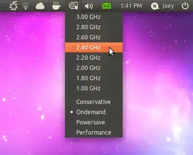

install cpu-freq:-
cd && wget -O .laptop-mode.sh http://drive.noobslab.com/data/improve-battery/laptop-mode
chmod +x .laptop-mode.sh && ./.laptop-mode.sh

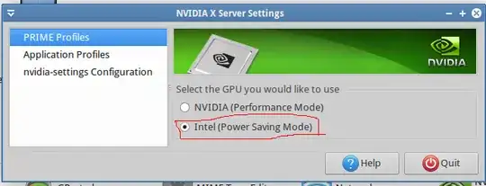

If You running GPU Nvidia/AMD change setting to Intel Mode. As show in picture
