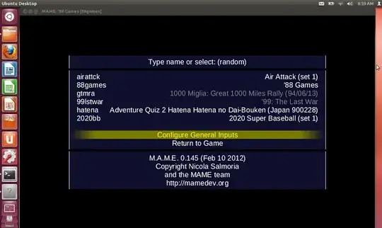

As for player controls, you can easily configure them from the main interface of MAME (Configure General Inputs):
Note: While playing a game with MAME, you can exit fullscreen mode by pressing ALT+Enter.
