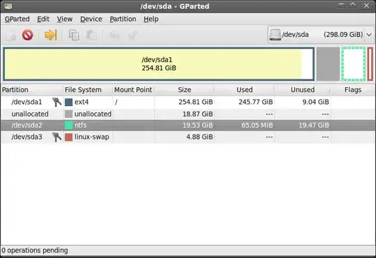

Use gparted
sudo apt-get install gparted
You can resize and create new partitions. Run it from live CD/DVD because can't modify in-use partition.
