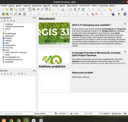

  1. First you need to install some tools:
    sudo apt-get install gnupg software-properties-common
  2. Now install the QGIS Signing Key, so QGIS software from the QGIS repo will be trusted and installed:
    sudo apt-key adv --keyserver keyserver.ubuntu.com --recv-keys 51F523511C7028C3
  3. Add the QGIS repo for the latest stable QGIS (3.12.x București):
    Note: lsb_release -c -s in those lines will return your distro name
    sudo add-apt-repository "deb https://qgis.org/ubuntu `lsb_release -c -s` main"
  4. Update your repository information to reflect also the just added QGIS one:
    sudo apt-get update
  5. Now, install QGIS!
    Note: add qgis-server to this line if you also want to install QGIS Server:
    sudo apt-get install qgis qgis-plugin-grass
and fire up [qgis3.12 screen shot1
Answer is delivered from this source
