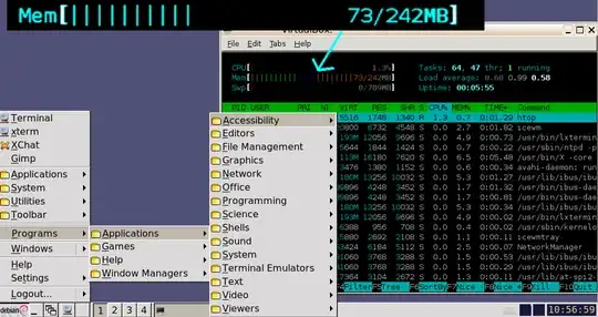

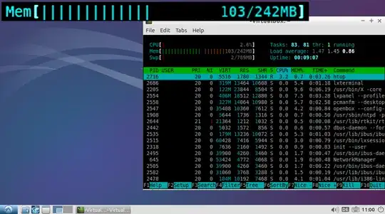

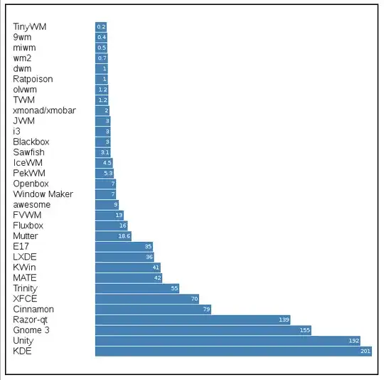

Here is a memory usage overview:
enter image description here Soure: A Memory Comparison of Light Linux Desktops on l3net
To install IceWM run this:
sudo apt-get install icewm
More info https://help.ubuntu.com/community/IceWM
LXDE vs IceWM
