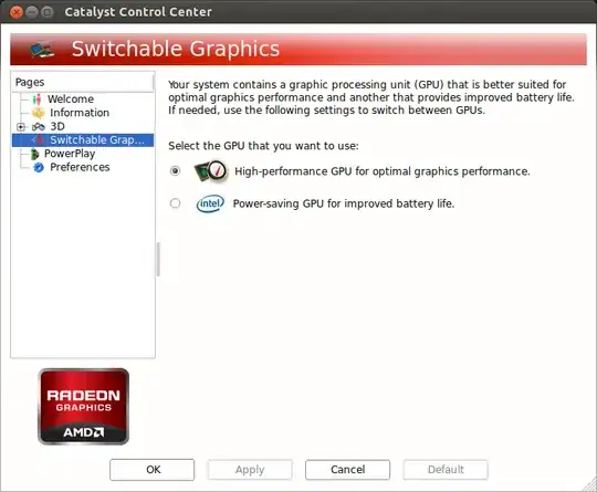

In windows, the AMD switchable graphics program lets me choose which programs use which video card, but in Ubuntu it seems I can only download the catalyst control center which lets me choose which graphics card to use all the time unless I go and change it. I installed the fglrx package and then the fglrx-update, that didn't work so I had to install the lastest drivers for the AMD card straight from AMD's website. That lets me open the control center, is this the only thing I can get for Ubuntu? Is there any way that I can choose which programs use which card?

It should be possible with Catalyst Control Center:
To install open your Terminal and execute:
sudo apt-get install fglrx
Then give a restart.
If you have trouble setting up visit Ubuntu/AMD Binary Driver Guide

In a modern system (see here for more details), at least when using the open source radeon drivers, you should be able to use the environment variable DRI_PRIME. Check if it works by monitoring the difference between
DRI_PRIME=1 glxgears -info
and
glxgears -info
I do not know if this thing is supposed to work with fglrx proprietary drivers.
If it works, you can add it to the .desktop file of the application you want to use the discrete GPU: Set variable in .desktop file
More info can be also found in Hybrid graphic card drivers (AMD® Radeon HD 8570 + Intel HD Graphics 4000), and, as ever, in the Arch Linux documentation pages.
