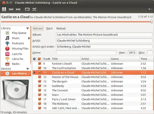

Look at this screenshot:
Rhythmbox wrong album info
It shows 19 tracks, which is the number of tracks in disc two, but track info from disc one. Even the time field is all wrong; when I took this screenshot, Javert's Suicide was still playing though Rhythmbox says that the play time for track 11 is over.

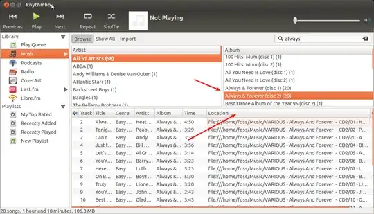

I've grouped some of these in my collection as shown in the following picture.
Now - the easiest way to do this is using Rhythmbox itself if its one of the common file types such as MP3, OGG. If you are using something Rhythmbox doesnt allow you to modify (see later) then its best to use software such as EasyTag and Picard to modify the tags in the music files themselves. Then Rhythmbox will see the modified album titles.

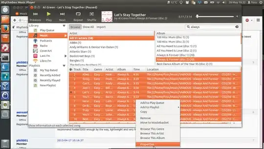

One technique I use is to add the file location to the tracks window - use the Preferences option to do this. Then you can order by file-location to group all the tracks in one file-location. Typically you would copy all tracks for album-disc 1 in the same location - album-disc2 will be is a separate folder.
Highlight all the tracks for one album, right-click and select properties

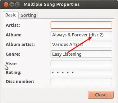

Finally, append the disc number to the album-title as shown and click OK.
All the album tags for the multiple tracks chosen will be updated.
