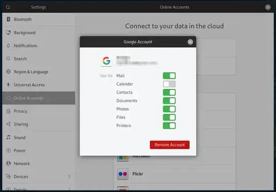

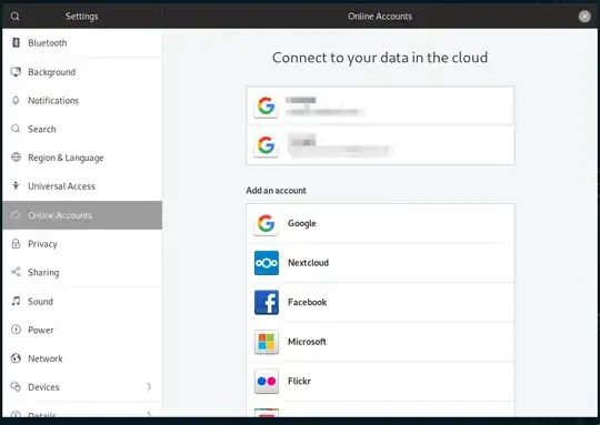

In my case, the calendars were shown because I added my Google accounts from the GNOME settings.
screenshot
When I added the accounts, I choose to use also their calendars, thinking I could later delete the ones I didn't need. I then discovered Evolution doesn't allow me to delete calendars.
What I did was opening the GNOME settings again, click on the accounts listed there, and deselect Calendar from them.
screenshot
I didn't need to remove the accounts and re-add them. Once I deselected Calendar from my Google accounts, I just closed Evolution and re-opened it. The Google calendars stopped to appear on Evolution.
