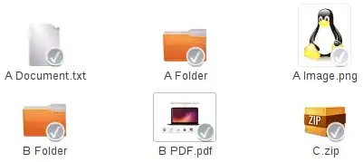

The grey Copy.com overlay icons, which indicate a file's synchronization or upload status in Nautilus, appear less integrated with the Ubuntu look and feel, compared to the icons that were used by the UbuntuOne client.
How can the Copy.com overlay icons be customized?
Copy.com Default Nautilus Overlay Icons

Follow these steps customize the Copy.com Nautilus overlay icons...
  1. First install the Copy.com Nauilus overlay emblems...
    sudo /usr/share/copy/x86_64/CopyCmd Overlay install
    (Replace /usr/share/copy/ with the location where you installed Copy. Also, replace x86_64 with x86 if you have a 32 bit computer).
  2. Replace the default emblems with custom icons. In this example, I've used the icons from the Humanity icon theme, which were used by UbuntuOne...
    sudo cp /usr/share/icons/Humanity/emblems/24/emblem-ubuntuone-unsynchronized.svg /usr/share/nautilus-copy/emblems/emblem-overlayerror.png
    sudo cp /usr/share/icons/Humanity/emblems/24/emblem-ubuntuone-synchronized.svg /usr/share/nautilus-copy/emblems/emblem-overlayinsync.png
    sudo cp /usr/share/icons/Humanity/emblems/24/emblem-ubuntuone-updating.svg /usr/share/nautilus-copy/emblems/emblem-overlaypending.png
    (If you like, you can also replace the progress bar icons located in /usr/share/nautilus-copy/emblems/).
  3. The overlay icons in Nautilus should automatically change; if they do not, you can refresh your Nautilus view by pressing F5.
