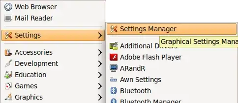

Another method to set nautilus as default using GUI :-
  1. Click on the top-left Xubuntu logo, it will display a menu
  2. Select SettingsSettings manager
    settings manager menu

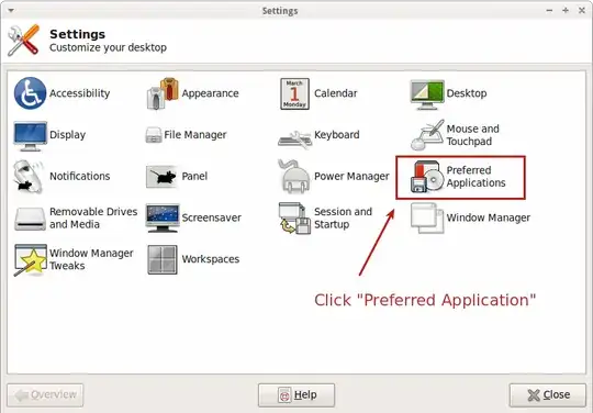

  3. The Settings window will open, Click on the Preferred Applications icon.
    settings manage window
  4. Then click on the Utilities tab and select nautilus from File Manager section
    preferred application window
That's it. Now nautilus becomes your default File manager.
