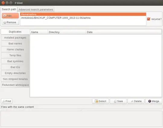

Here is a screen-shot of the main screen.  There are many advanced features, but basic usage of the application is relatively straightforward.
Click the Add button at the top left to add all the directories you would like to check.  Obviously, you can remove directories using the Remove button.
Make sure the recurse? check-box at the the right is selected.  Then click the Find button.  (Any errors, such as file permission issues, will be printed at the bottom of the FSlint window).

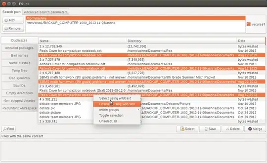

FSlint will list all of the duplicate files, their directory locations, and the file date.  FSlint also presents you with the number of bytes wasted due to the redundant files.
Removing Duplicates
Now you can select multiple files using the Shift or Ctrl keys and left mouse button.  If you want to select multiple files automatically, click on the Select button and you will be given options such as selecting files based on date, or entering wild card selection criteria.
If you need to use the list of selected files outside of FSlint (perhaps as input to your own script) click on the Save button to save a text file.
Finally you can delete the selected files using the Delete button, or you can merge the selected files using the Merge button.  Note that the Merge feature removes the unselected files from your system and creates hard links to the corresponding selected files.  You would use this feature if you wanted to keep your existing file structure, but wanted to free up some space on your system.
