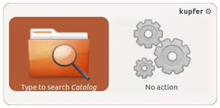

I am running Ubuntu 14.04. and installed Kupfer 208.
Kupfer

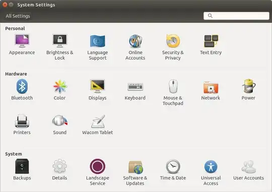

For some reason I cannot search and launch the applications from System Settings such as Display or Appearance. The Unity launcher finds all of them.
System Settings
I looked through the settings and list of plug-ins but could not find out how to index the System Setting.
