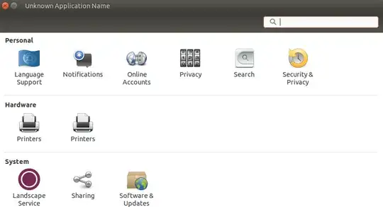

Is it normal to have such a reduced system settings menu in Ubuntu 14.04? No options for keyboard, sounds...
right click on shut down and then selection on system settings
I noticed in the comments TuKsn mentioned to use
gksu unity-control-center
You said this came up with an error. Instead, try the following:
sudo apt-get install unity-control-center
If you do not yet have it installed, it will ask if you wish to install it (y/n). If you do have it installed, which is likely, it will make sure you have the newest version. Some of the solutions found at Missing System Settings after removing some packages may also help.
