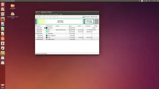

To have a fresh installation I was told I need to format the partition it is on and simply re-install Ubuntu. I am currently on a live cd and was going to format it but apparently its mounted so I can't format it.
I'm not sure what to do and I would like Ubuntu back with out screwing something up. Btw I dual-booted it so I would also like to do this without screwing up the Windows partition.

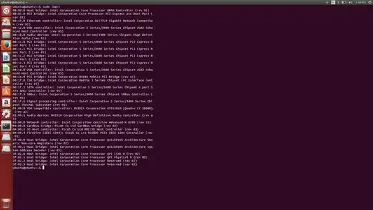

screenshot of gparted: Lspci:

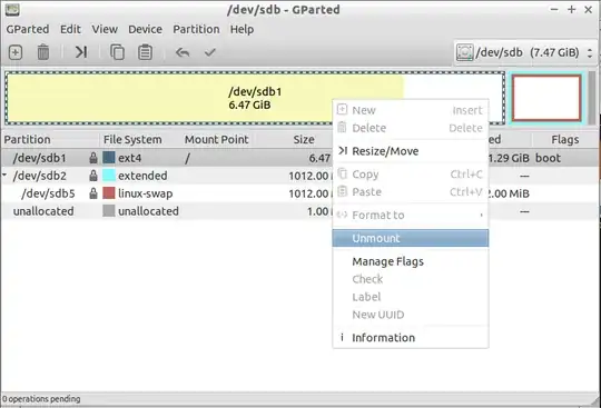

to unmount your partition
  • open gparted
  • right click the partition you want to unmount
  • select the unmount option
Imgur

  1. Open Gparted and expand the /dev/sda4 partition.
  2. Select the /dev/sda6 partition, click the "Partition" menu dropdown, and select 'Delete'
  3. Repeat step 2 for the /dev/sda5 partition
  4. Now repeat step 2 for the /dev/sda4 partition (it should now allow you to delete it, now that this Extended Partition is empty.)
  5. Exit gparted (it will probably ask you to confirm you want to write the changes to disk. Agree/click yes.
  6. Reboot into the Live Ubuntu disk again and open GParted to verify the /dev/sda4 -sda5 and -sda6 partitions are really gone.
  7. Install ubuntu normally, choosing to boot it alongside Windows.
Adding this text for background.
See, the problem is GParted is doing it's job. You can't delete the /dev/sda4 partition because it is an Extended Partition, and it contains Logical Partitions. Most partitioning tools won't let you arbitrarily delete an Extended Part. if it isn't empty.
