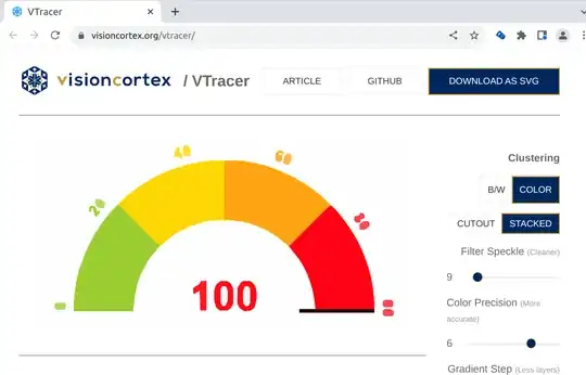

I found VTracer
It is open source and there is an online converter.
The source code is at Github: https://github.com/visioncortex/vtracer
