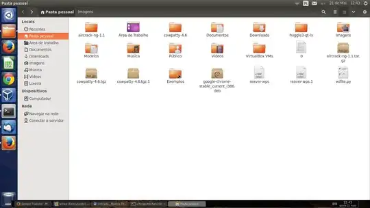

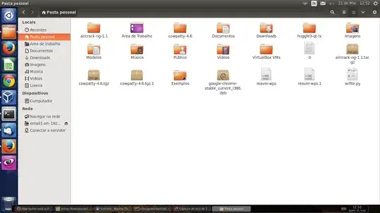

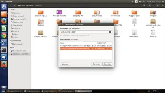

When I turn on my Ubuntu 14 I have always search my smb.
But I use every day, How can I hold smb in Personal folder?
See the pics below
See here See here See here

if you want to have your network shares mounted at boot time, you have to edit your /etc/fstab file. Go to a terminal and type
 sudo apt-get install cifs-utils
 mkdir ~/DirectoryNameInYourLocalFolderToMountTo
 sudo nano /etc/fstab
Add one of the following lines to the end of the file... (change servername/sharename,etc..)
If not password protected..
//servername/sharename  /home/Pasta\ personal/DirectoryNameInYourLocalFolderToMountTo     cifs  guest,uid=1000,iocharset=utf8  0  0
If password protected..
//servername/sharename  /home/Pasta\ personal/DirectoryNameInYourLocalFolderToMountTo     cifs  username=msusername,password=mspassword,iocharset=utf8,sec=ntlm  0  0
When you are finished, hit Control-O (the letter) then Enter to save. Then Control-X to exit
Now you can either reboot, or remount your filesystems from the command prompt with sudo mount -a
