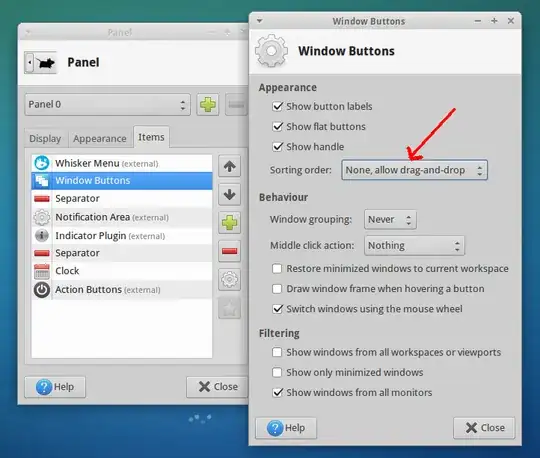

It should be possible with this configuration:

As of Xubuntu 18.04, to manually rearrange the position of taskbar tabs:
Settings > Panel > Item > Window Buttons > Edit the currently selected item (5th button from top) > Sorting Order > None, Allow Drag and Drop.
