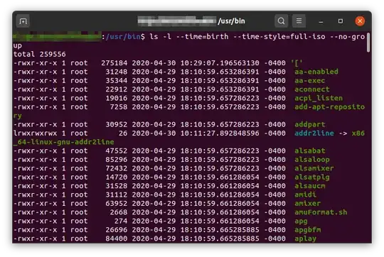

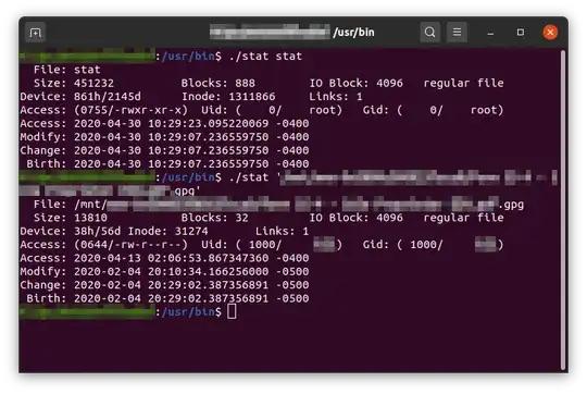

My OS (Ubuntu 20.04, which comes with Linux kernel 5.4.0-28 and GLIBC 2.31) only came with GNU coreutils 8.30, so I had to get it to work by compiling version 8.32 of GNU coreutils from source. It was a relatively pain-free procedure.
Afterwards, both ls and stat could work with birth time.
Output of ls -l --time=birth --time-style=full-iso --no-group: ls with birth time
Output of stat on an ext4 file system and a btrfs file system: stat with birth time
