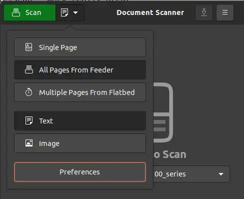

hplip + simple-scan work really great!!! (as long as your hplip version is compatible with your printer)
sudo apt install hplip simple-scan
The problem I had is that when I tried to scan from the feeder it just kept scanning from the flatbead instead, over and over again
Then I realized my hplip version was a bit old and didn't support my new printer, that's why it wasn't recognizing it and Ubuntu was using a generic driver. Check compatibility here (apt show hplip | grep -i version to see your hplip version)
You can manually install the newest hplip here https://developers.hp.com/hp-linux-imaging-and-printing/gethplip
BTW, although hplip's software didn't recognize my network printer, simple-scan did recognize a new device
