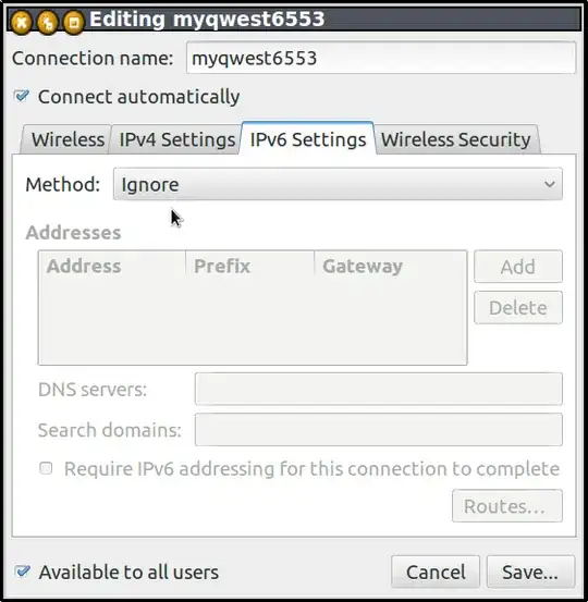

Wireless drivers for ubuntu and linux are a little touchy when it comes to connecting to routers with certain settings, I am going to recommend the best settings to use.
I recommend that you change the encryption type in your router to WPA2 with AES (CCMP). Make sure not to select the WPA or WPA/WPA2 mixed mode, as that will again need TKIP which is discouraged.
Go into network manager and set your wireless settings to match the screenshots for best results. wireless settings1wireless settings2
