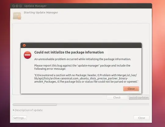

Currently, when I run the Update Manager in 12.04.1 LTS , I get since some weels:
Screen shot
How can I update from this state?
Update

To solve this problem , open terminal then try these commands :
sudo apt-get clean
cd /var/lib/apt
sudo mv lists lists.old
sudo mkdir -p lists/partial
sudo apt-get clean
sudo apt-get update
