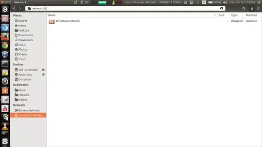

Open Nautilus and click 'connect to server'. Shown in picture below on bottom left. enter image description here

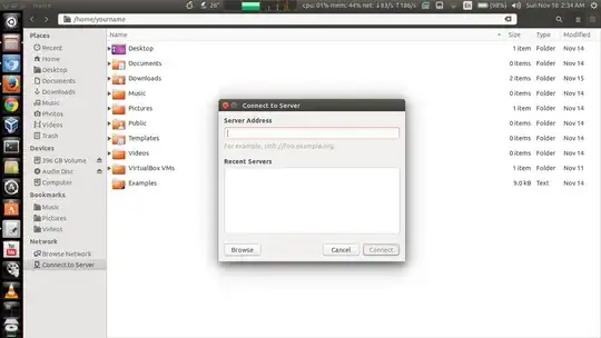

A dialog box will show up that says 'connect to server' like in the picture below: enter image description here
Now type nfs://hostname or static ip
