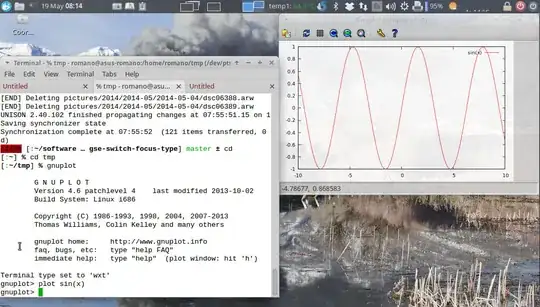

gnuplot is a command-line program; you have to run it in a terminal emulator. On Ubuntu the keyboard shortcut CTRL+ALT+t is set to open a new terminal window by default, but you can of course also find the terminal emulator in the Dash (or main menu).
In the terminal window, you can simply type gnuplot to launch the gnuplot command prompt. In order to plot your example, sin(x), on the gnuplot prompt, you can simply type:
plot sin(x)
to obtain:
screenshot showing the usage of gnuplot
There is a great tutorial in the Gnuplotting page...
