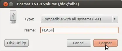

Firstly, you need a USB stick formatted in the most basic way possible. This will erase all data on your USB stick, so back up anything important first!
  1. Plug in your USB stick.
  2. Select the Format... option from the launcher menu:
    Format menu screenshot
  3. Select Compatible with all systems (FAT) as the type, give it a sensible name, and click Format:
    Filesystem options screenshot

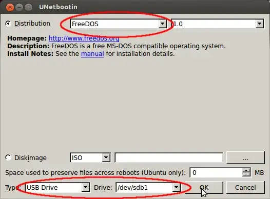

Then you need to use UNetbootin to make the USB stick boot to an DOS prompt:
  1. Install UNetbootin either using the Software Centre or from the command line using sudo apt-get install unetbootin.
  2. Run UNetbootin. Select FreeDOS as the distribution and make sure the type is USB Drive and the correct drive is selected. Then click OK:
    UNetbootin options screenshot
  3. When UNetbootin has finished, click Exit.
Now you have a USB stick that will boot to DOS.

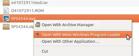

If they came in a self-extracting .exe file, you need to run it in order to extract the files. To do this, you'll need to:
  1. Install Wine either using the Software Centre or from the command line using sudo apt-get install wine.
  2. Find the .exe file that contains the BIOS files, right click it and run with Wine:
    Open with Wine screenshot
  3. The exact details of what happens next will depend on your BIOS file, but extract the files to a directory somewhere you can remember.

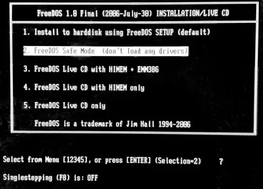

  4. You should see the blue FreeDOS boot loader appear with Default highlighted. Either wait 10 seconds or press Enter.
  5. At the FreeDOS menu, select the second option FreeDOS Safe Mode (don't load any drivers):
  1. You will end up at an A:/> prompt. Type C: then Enter to switch to the C drive.
  2. Type dir then Enter and you should see all your files that you copied onto the USB stick.
  3. Run the script or executable that you identified previously as the one to apply the BIOS update. In my case, I just had to type FLASH then Enter to run the FLASH.BAT file.
  4. You should see the flash script applying your BIOS update. Do not power off or interrupt this process; wait until it has finished. It should return you to the C:\> prompt.
