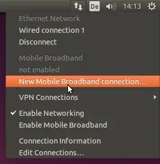

  2. Create a new Mobile Broadband connection
    Select New Mobile Brodband connection... from the network indicator.
    network indicator with highlighted "New Mobile Brodband connection..." entry

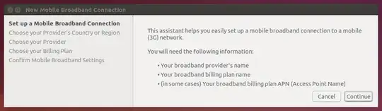

    This will bring up the mobile broadband setup wizard.
    Alternatively you can click Edit Connections..., then click the Add button in the Network Connections menu and select Mobile Broadband as the Connection Type, which will then also bring up the wizard shown below.
    New Mobile Broadband Connection setup wizard
    Follow the instructions and choose settings according to your country and provider/carrier. Mine looks like this:
    New Mobile Broadband Connection setup wizard, final step
  3. Done
    That's basically it, you should have a working Internet connection in a few seconds when you hit the Continue button.

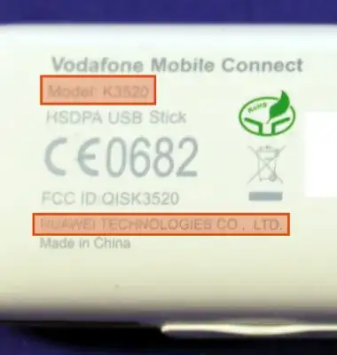

Determining which device you are using
You should also find out which dongle you have (as you can see in the example it's not always quite obvious and the lsusb output may also not be accurate), search for it online and provide maker and model name along with to Ubuntu version you are using when you ask a new question, thus helping everyone finding questions already asked and corresponding answers.
There are only a few manufacturers of these dongles, namely Huawei and ZTE, but a lot of carriers re-brand them. Here is how it looks on mine:
image of the backside of one of these re-branded dongles, showing modelnumber and manufacturer
It's a Huawei K5320. (A very old device. This is not meant to be a recommendation.)
