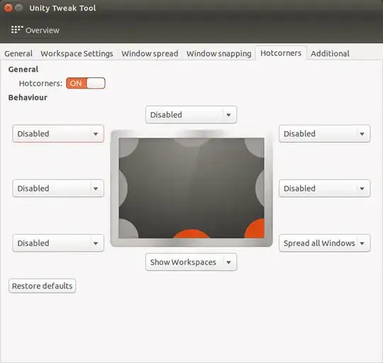

On Unity desktop, I have enabled hot corners using. Unity Tweak Tool. It's just that they are too sensitive, I too often activate them by mistake.
I couldn't find an option to set a delay for it in the tool, is there any way to do that?
Just an image of how I am left without that option

You can edit the delay of hotcorners by installing the compizconfig-settings-manager (Ubuntu Software Centre). In the settings manager you can edit the 'edge trigger delay' in general optoins, for example, try 250.
