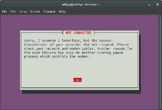

Then, I tried to once again run sudo pppoeconf, which gave me the following output (I have tried this in both PPPoE as well as Bridging modes):
output of sudo pppoeconf

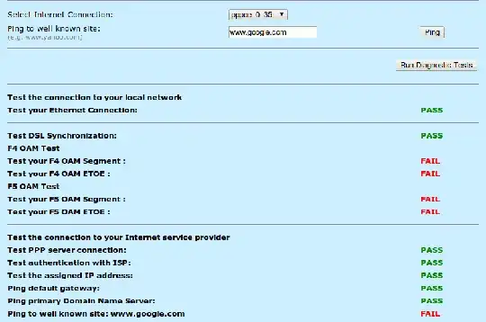

Running the diagnostic tests on my modem on both Ubuntu and Windows gives this output:
Modem's diagnostic tests
Everything is working as it should on my Windows 7 dual-boot system, but not on Ubuntu GNOME 14.04 anymore.
