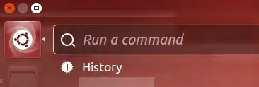

For running direct commands, there are two ways.
  • Either run in Terminal
  • Or run from the "Run Command" dialogue (screen shown below) obtained from Alt+F2
Then, Is there any difference between them? (working same & shell) or redirects to same?
