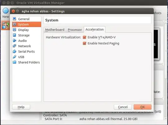

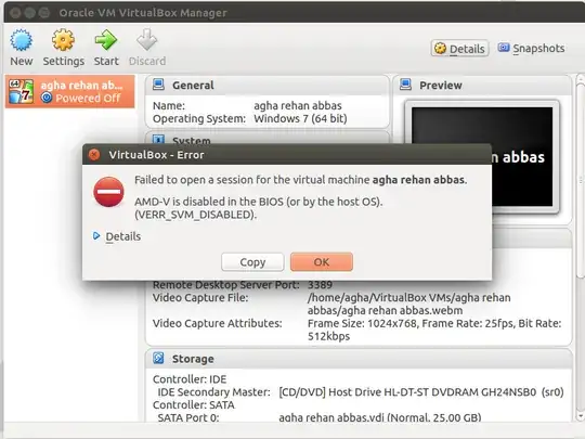

enter image description herei have installed the extention packs of virtualbox a few monent ago and and again i click the button to install it it shows an other error related to BIOS enter image description here
currently i am using an integrated motherboard of gigabyte company is there any solution for this issue
i have vt-x amd amd-v enabled
Type the following command as root to verify that host cpu has support for AMD - V technology:
# grep --color svm /proc/cpuinfo
If the output has the svm flags, then AMD CPU host is capable of running hardware virtualization. Then check in your system BIOS if the virtualization is enabled.

Your system does not support AMD-V. So that unchecked Enabled VT-x/AMD-V.
You got your problem resolved.
