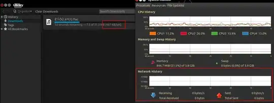

I found the speed value of network monitor in System Monitor cannot be shown after upgrade to Ubuntu 14.04. Including indicator-multiload and dstat
Example 1:
I can see the download speed is 467KB/Sec in firefox Downloads, but nothing shows (zero) in Network History firefox downloading

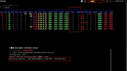

Example 2:
In the following image, git downloading speed is 358KB/Sec, but the receive/send value in dstat is still 0. And nothing shows in indicator-multiload
git download
I can get that, the network speed monitor is disabled somehow. How can I make it right?

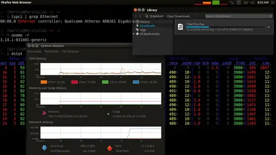

As @Aditya and @Bryan suggested, this is the bug in kernel, and it can be fixed by update kernel.
For example: My system is Ubuntu 14.04. The version of kernel is 3.13.0, and the system is 64bit (amd64).
They all can be got by commands as blew:
┌─ (marslo@MarsloJiao ~) ->
└─ $ uname -r
3.13.0-30-generic
OR
└─ $ dpkg -l | grep "linux\-[a-z]*\-"
ii  linux-headers-3.13.0-24                               3.13.0-24.47                                        all          Header files related to Linux kernel version 3.13.0
ii  linux-headers-3.13.0-24-generic                       3.13.0-24.47                                        amd64        Linux kernel headers for version 3.13.0 on 64 bit x86 SMP
ii  linux-headers-3.13.0-30                               3.13.0-30.55                                        all          Header files related to Linux kernel version 3.13.0
ii  linux-headers-3.13.0-30-generic                       3.13.0-30.55                                        amd64        Linux kernel headers for version 3.13.0 on 64 bit x86 SMP
ii  linux-headers-generic                                 3.13.0.30.36                                        amd64        Generic Linux kernel headers
ii  linux-image-3.13.0-24-generic                         3.13.0-24.47                                        amd64        Linux kernel image for version 3.13.0 on 64 bit x86 SMP
ii  linux-image-3.13.0-30-generic                         3.13.0-30.55                                        amd64        Linux kernel image for version 3.13.0 on 64 bit x86 SMP
ii  linux-image-extra-3.13.0-24-generic                   3.13.0-24.47                                        amd64        Linux kernel extra modules for version 3.13.0 on 64 bit x86 SMP
ii  linux-image-extra-3.13.0-30-generic                   3.13.0-30.55                                        amd64        Linux kernel extra modules for version 3.13.0 on 64 bit x86 SMP
ii  linux-image-generic                                   3.13.0.30.36                                        amd64        Generic Linux kernel image
ii  linux-libc-dev:amd64                                  3.13.0-30.55                                        amd64        Linux Kernel Headers for development
ii  linux-sound-base                                      1.0.25+dfsg-0ubuntu4                                all          base package for ALSA and OSS sound systems
So, the following steps can fix the problem:
  1. there are three deb packages should be downloaded from /~kernel-ppa/mainline/v3.14.1-trusty first:
  2. Install all these debs
    • $ sudo dpkg -i *.deb
  3. Reboot your system
    • $ sudo reboot
Bingo! The network speed back to the system monitor!! systemmonitor
