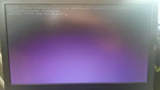

The issue I am facing is that I get the following error on boot, after I select Ubuntu in GRUB:
Error: File "/vmlinuz-3.13.0-24-generic.efi.signed" not found.
unaligned pointer 0xd0a26c68
Aborted. Press any key to exit.

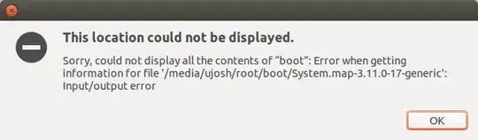

Error in nautilus
Clicking on the mounted boot-Partition (/dev/sda2) in nautilus gives the following error:
Sorry, could not display all the contents of “boot”: Error when getting information for file '/media/ujosh/root/boot/System.map-3.11.0-17-generic': Input/output error
