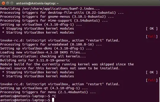

I am trying to install virtualbox and make it work but it doesn't seem like I can. In the image you can see the output.
Command line output

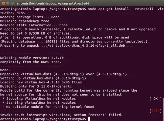

But virtualbox-dkms is already installed and at the latest version. So I tried to reinstall it and i got this:
cli output 2

EDIT:

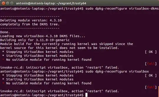

The output after reconfigure (@M.Tarun suggestion):
cli output 3
EDIT 2:
Also installed the sources as @Hmayag instructed, purged virtualbox and installed it again but I got the same problem.

Basically after you install those two packages you also need to do the reconfiguration:
sudo dpkg-reconfigure virtualbox-dkms
sudo modprobe vboxdrv
And to fix eth0:
sudo modprobe vboxnetflt

The reason for the problem is that you have booted the 3.11 kernel while the dpkg-reconfigure expects a 3.13 kernel. That's why you get the message 'no suitable module for the running kernel'.
Be sure to update your bootloader.
In my case the bootloader is updated from another OS (Debian) and booting to that and running sudo update-grub solved the problem.
